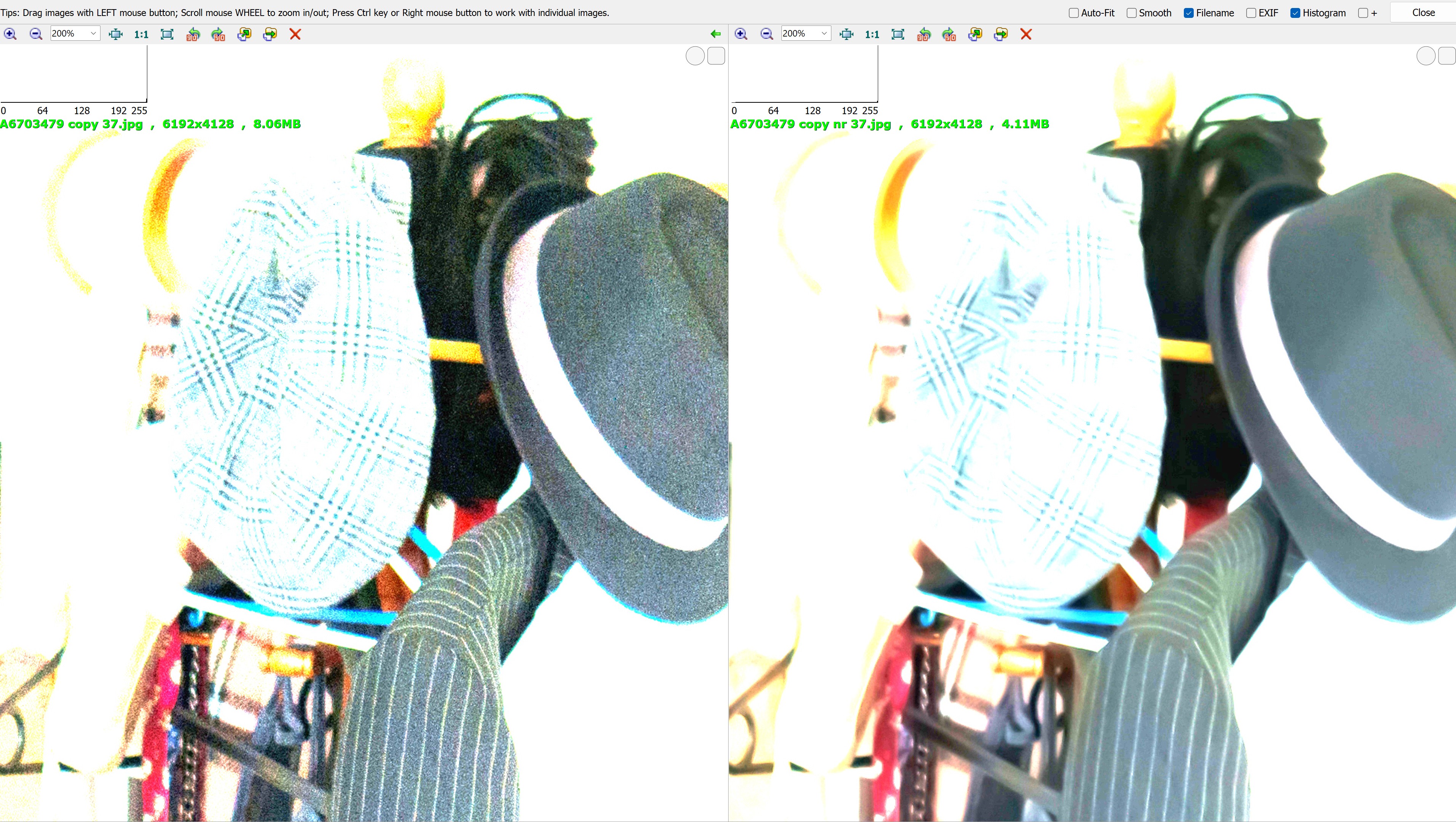

This kind of noise removal (like you displayed) is pure c**p. If it is your camera NR, then turn it off and use proper NR in postprocessing.
But even processes in this way DR is increased - if DR is calculated as maximum signal / noise floor - because noise is much less.
I think you are talking about some different, much more subjective definiton of DR - ability to record [overexposed] highlights and deep shadows into same image, independently of noise level.
