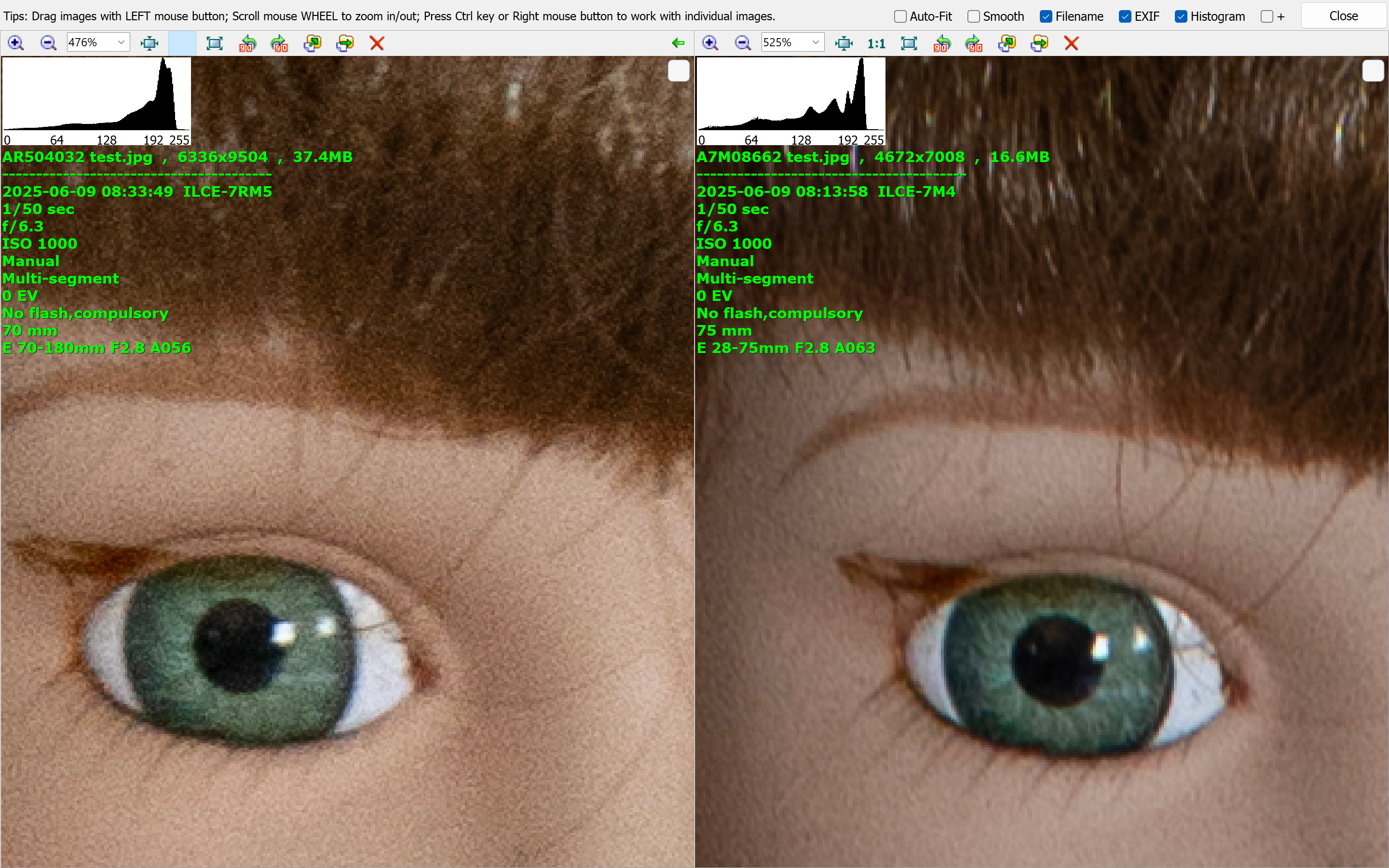

    Why the different lenses and focal lengths, for the same lens mount? The right-side image has color fringes (red and blue) in the specular lights on the cornea, and the left-side image does not. Obviously the lenses and/or different processing are playing roles here; not just different pixel densities. Also, you lose the guarantee of equal exposure when you use different optics, especially at low f-numbers like 2.8, where the actual transmission varies wildly with different lenses. Also, at f/2.8, most zoom lenses have much more aberration than diffraction, and so total blur will be different. The focal lengths are different; did you adjust distance, accordingly, for the doll's eye to be the same size in mm on the sensors?
    Again, Nearest Neighbor upsampling gives predictable results with the same scene and optics; the larger the pixels, the higher the maximum contrast between neighboring pixelated pixels. If you use a sharper lens with the bigger pixels, then you're going to have even more high-contrast between the pixelation neighbors (horizontal and vertical, only). This is what the primitive levels of our brains look for to feel like we have successfully focused on an object, which can fool us into mistaking this acuity for actual image information.
    So, there are just too many wild cards here for your test to have any meaning.
  • Members 2663 posts
    July 12, 2025, 2:37 a.m.
    The 2 tamron lens are both equally as sharp as each other i just framed the doll to the correct composition. lens breathing is most likely playing a part in the different focal lengths, its only 5mm 😏, as a guy over in the sony forums has also noticed his a7iv images appeal more over his a7r5, at least he being honest with him self. i just shot identical images from 2 tripod set ups at different iso readings to see when noise started to decreases detail . it starts at iso 320.
