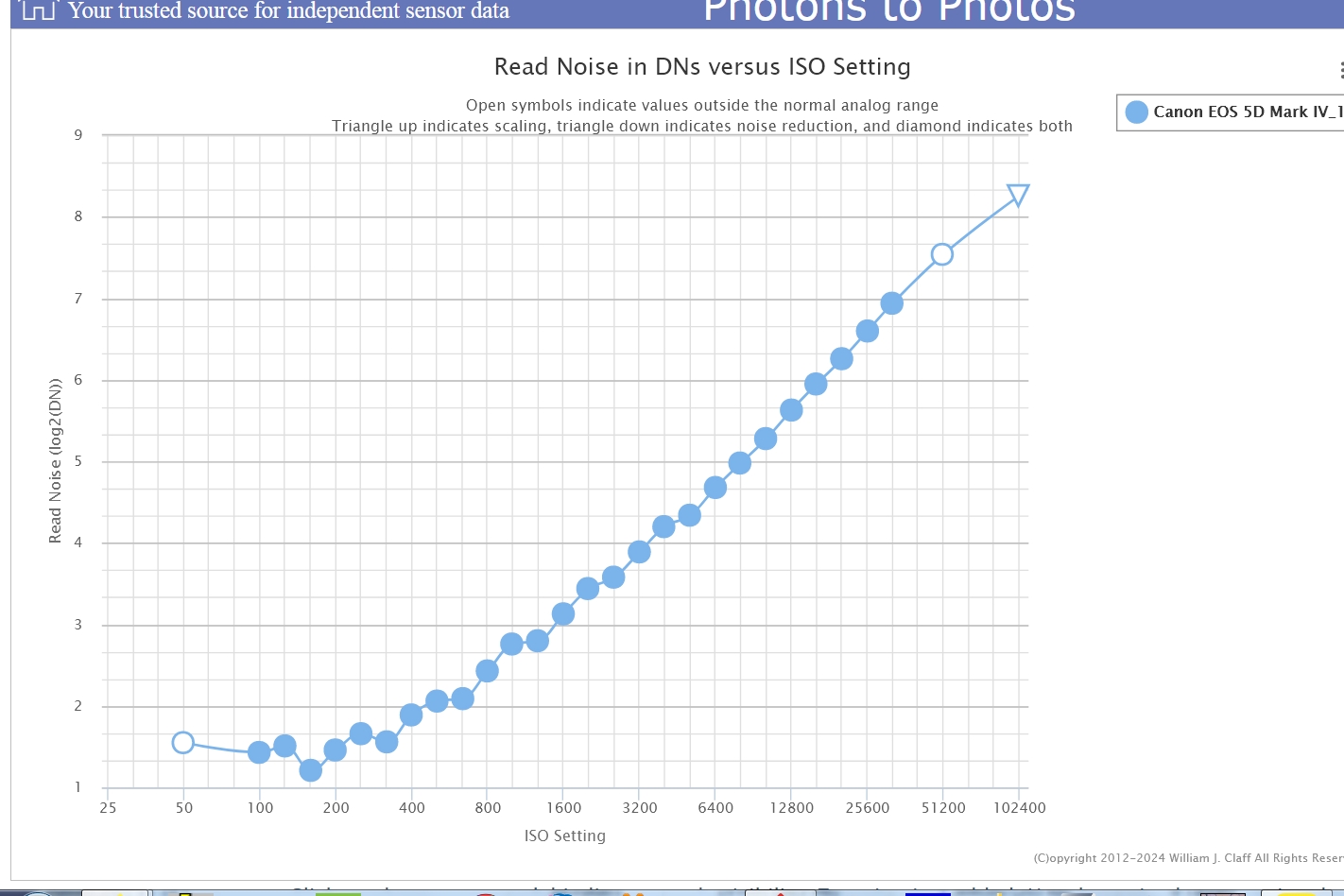

    I found this: Aptina paper on dual-gain sensor (PDF)
    It includes circuit diagrams (sorry), where it is clearly seen that they change well capacity, which affects sensor sensitivity before any amplification. As read noise is related to ADC and amplification, then read noise (which is one of noise sources, defining DR) is about the same for low-gain mode and high-gain mode (this is nicely seen in your X-T5 graph).
    What happens in Canon, is not that clear - but I suspect there is some similar technology applied.

    As regards "dual gain" my original response to Alan was this and no more:
    There is a technology licensed by Aptina which applies extra capacitance to each photocell requiring more exposure for a given scene, if so applied.
    Since ISO(SOS) = 10/(mean exposure) for a mid-gray output, the effective exposure index (ISO number) is reduced when extra capacitance is applied.

    Alan, The Aptina method adds a fixed value of capacitance to the photosensor at low ISO settings, hence the term "dual". That lowers the "gain", meaning that more exposure is needed for the sensor to give the standard output (mid gray). See kronometric.org/phot/std/DC-004_EN.pdf for what the standard output is.
    Terminology: the extra capacitance cuts out, not "in", above a certain ISO setting.
    Generally speaking in photography the more the exposure, the higher the Signal-to-Noise Ratio, meaning less noise relative to the signal.. This affects the meaning of "less noise" in your question above. In photography there are a good few parameters which are relative to something but, when expressed as values, often get the qualifier "relative" left out by authors.

    Just so's we know, Alan's posted graphs in question are not showing "theoretical noise levels" vs. ISO.
  • July 2, 2025, 6:50 p.m.
    Andrew,
    That is an interesting observation. My question is purely to saisfy my curiosity. I always like to know WHY things are happening even if I never use them 'in anger'.
    So, I'd still like to know why the Canon graph has those points which seem to go against my understanding of sensor noise & DR.
  • Members 1570 posts
    July 2, 2025, 7:11 p.m.

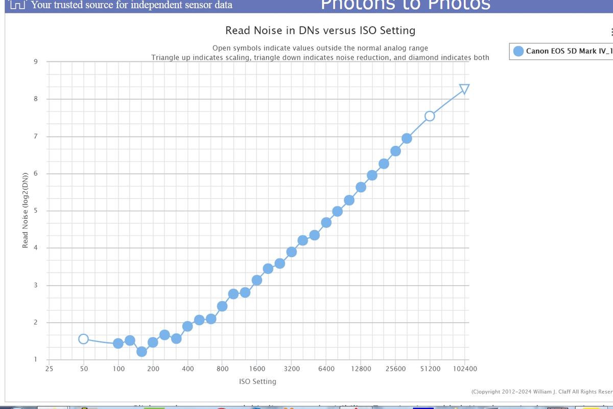

    Here's a noise graph for a Canon FWIW
    JPG, 255.5 KB, uploaded by xpatUSA on July 2, 2025.
  • July 2, 2025, 7:31 p.m.
    It seems to be mostly Canon-specific effect - looking at different cameras DR and noise graps on different sources, many Canons (including 5DMk3) have strange noise behavior at lower ISO values - exactly like Ted's graph displays. On Magic Lantern (Canon firmware mod) site it was told that they have two amplifiers before ADC and those have not ideally configured either - it is quite possible that such setup creates some noise floor, which makes DR values (signal/noise) dependency on ISO settings a bit strange.
