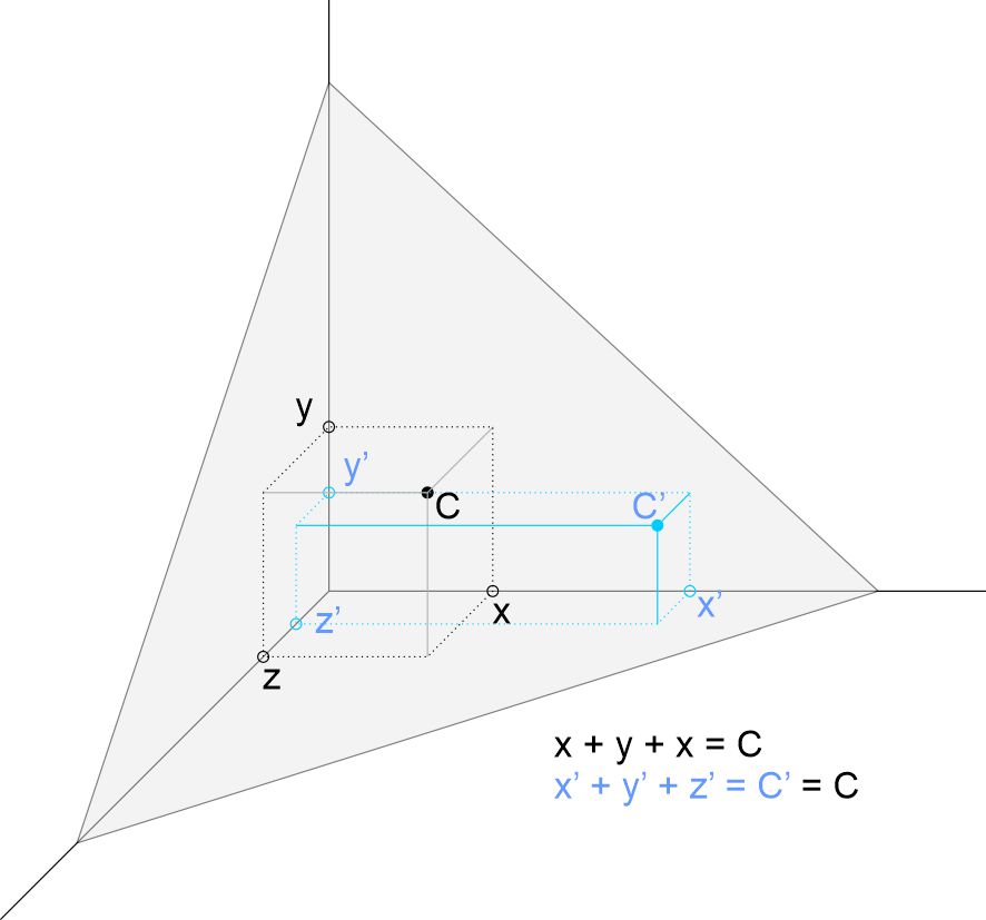

    Your image didn't show for me, I attached it:
    If you are talking about my plane model, then no, entire plane is of constant brightness and we can set point C anywhere - its coordinates (converted to real S/A/ISO values) give always same result. For different brightness you have to shift the plane.
    If you are talking about your linked triangle, then I can't find correct mathematical way to describe relationship of parameters. You can fix one parameter - shutter speed, draw perpendicular (vertical) line from that parameter value, take any point of it, draw two lines, perpendicular to other sides and you get three values, giving you identical result. Unfortunately starting from other sides (A or ISO) does not work this way.

  • April 4, 2026, 10:08 p.m.
    JPG, 46.7 KB, uploaded by ArvoJ on April 4, 2026.
  • Members 1570 posts
    April 4, 2026, 10:42 p.m.
    typo? x+y+x?
  • April 5, 2026, 10:30 a.m.
    Typo of course, sorry.
