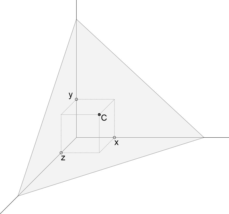

    No illustration ... so unable to visualize your "parameters" ... I fold.
    I've yet to find a triangle whose inside angles don't add up to180 deg, so obviously I don't get it.
  • March 31, 2026, 5:08 p.m.
    Can you let your ChatGPT friend to visualise it?
    Google search AI gives strong hint: The equation x+y+z=C represents a plane in three-dimensional (3D) space.
    Visually it is tilted plane through three points (C,0,0), (0,C,0), (0,0,C), in positive octant (x, y, z ≥ 0) it looks like triangle. Exposure triangle, if you want :)
    Why this equation?
    In short and wihtout constants, S * A * ISO = B, where S is 1/shutter speed, A is relative aperture (F/aperture), ISO is ISO value and B is resulting brightness.
    Taking logrithm (as all components are actually exponential in nature), we get
    log(S) + log(A) + log(ISO) = log(B)
    Assuming we strive for constant brightness and substituting logarithms with x, y, z and C correspondingly, we get
    x + y + z = C
    You may draw it out now :)

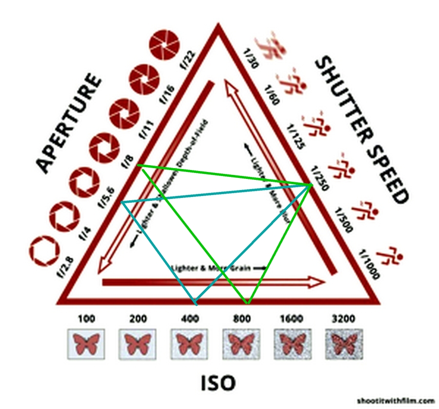

    April 2, 2026, 4:10 p.m.
    Indeed it ain't ... here's an illustration with inner triangles added for two "balanced" settings but something doesn't seem quite right ...
    Comments invited ... I really would like to get to the technical basis of the Triangle because it is so easily understood by others and because I still don't quite get it, grump.

  • Members 1923 posts
    April 2, 2026, 11:51 p.m.
    The triangle wasn't meant to be read from as one would read from a graph. It is more an indicator of the relationship between the 3 attributes.

  • Members 2663 posts
    April 3, 2026, 8:27 a.m.
    because your lines are OFF 😊try drawing them more accurate.
    April 3, 2026, 10:15 a.m.
    if you draw the lines accurately they will all meet at the centre point of all the triangles.

  • April 3, 2026, 11:57 a.m.
    It is a plane of constant (resulting) brightness, every point coordinates are combination of three values (corresponding to logarithms of S, A and ISO), which give identical result. Intersection of plane and coordinates octant gives us a triangle.
    I marked some point C on the triangle and draw its coordinates x, y, z. These correspond to my previous post variables.
    JPG, 38.6 KB, uploaded by ArvoJ on April 3, 2026.
    April 3, 2026, 12:35 p.m.
    Ahhhh, thanks.
    The "constant brightness" was what I was missing. I couldn't see how the plane covered varying lightness. It doesn't. Different lightness, different plane.
    Having said that, my line idea was no better - didn't allow for varying lightness...

    April 3, 2026, 3:47 p.m.
    Seeking clarification as to the time factor ... should the octant be made positive somehow (can't have negative brightness and time is fractional so log(t) is negative). On the same basis, what about log(A=f/0.95) = -0.223?
    For example, if log(C) = log(S)+log(A)+log(t) and S=400 and A = f/5.6 and t=1/250, log (t) = -2.398 so not a positive octant ...
  • April 3, 2026, 5:12 p.m.
    Entire idea is not limited to positive octant, it just makes nice triangle there :) Of course plane continues to negative values, logarithms of positive values span range from -∞ to +∞ - no problems with that.
    It is same for your 'normal' exposure triangle - if you choose some parameter outside of range, written there on the sides, then results are also located outside of it.

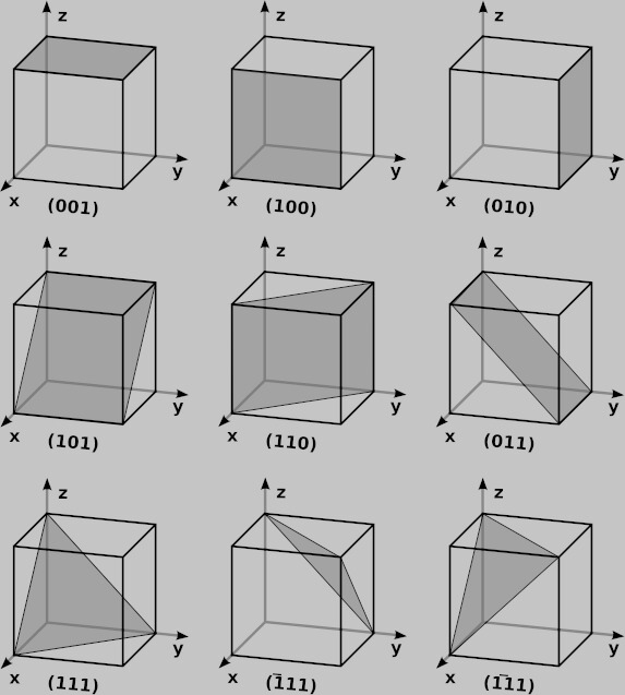

  • Members 1570 posts
    April 4, 2026, 2:02 p.m.
    Miller Indices ... pick one ... 🤔
    JPG, 53.5 KB, uploaded by xpatUSA on April 4, 2026.
  • April 4, 2026, 4:04 p.m.
    Just simple aid to draw coordinates of the point.
