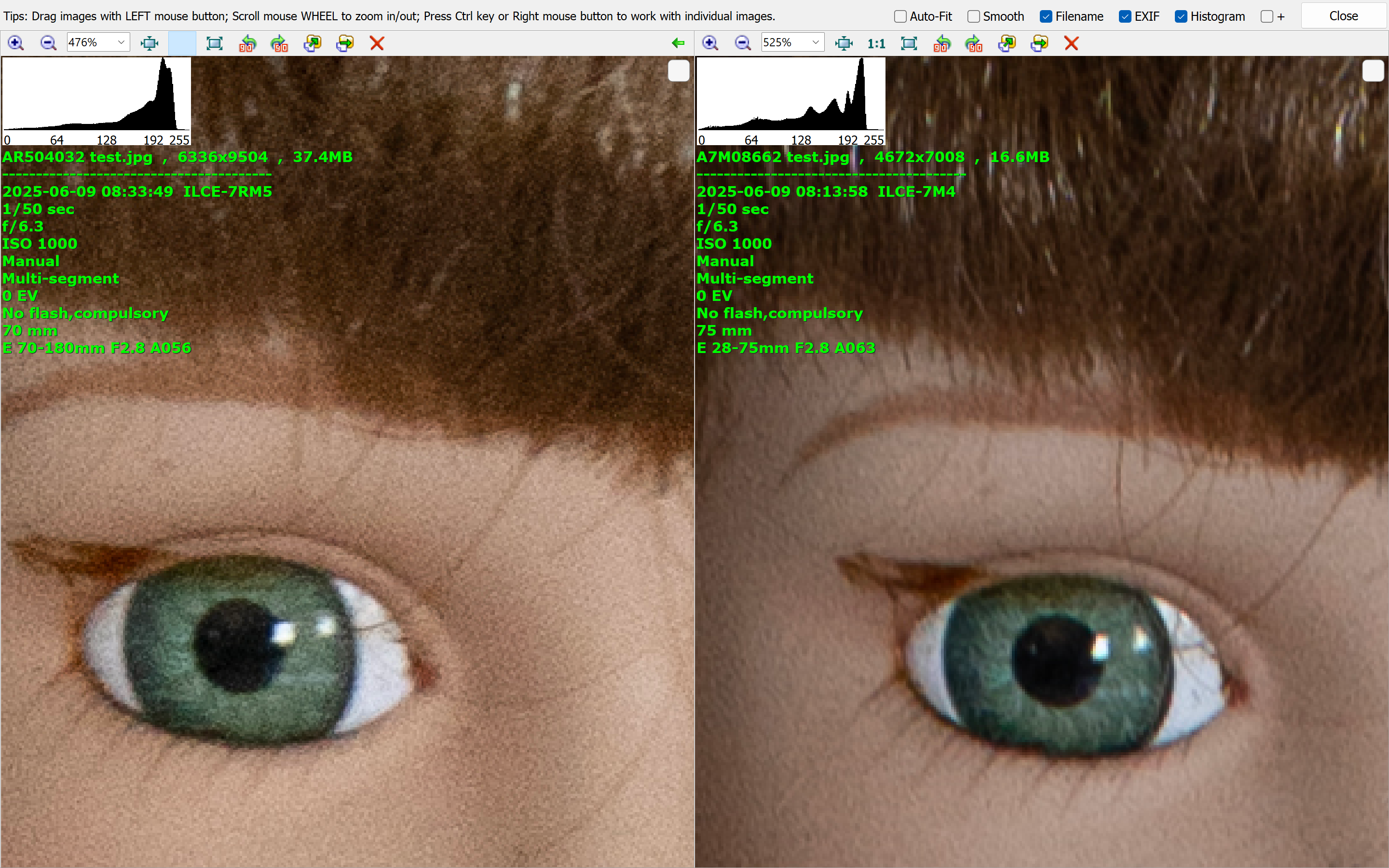

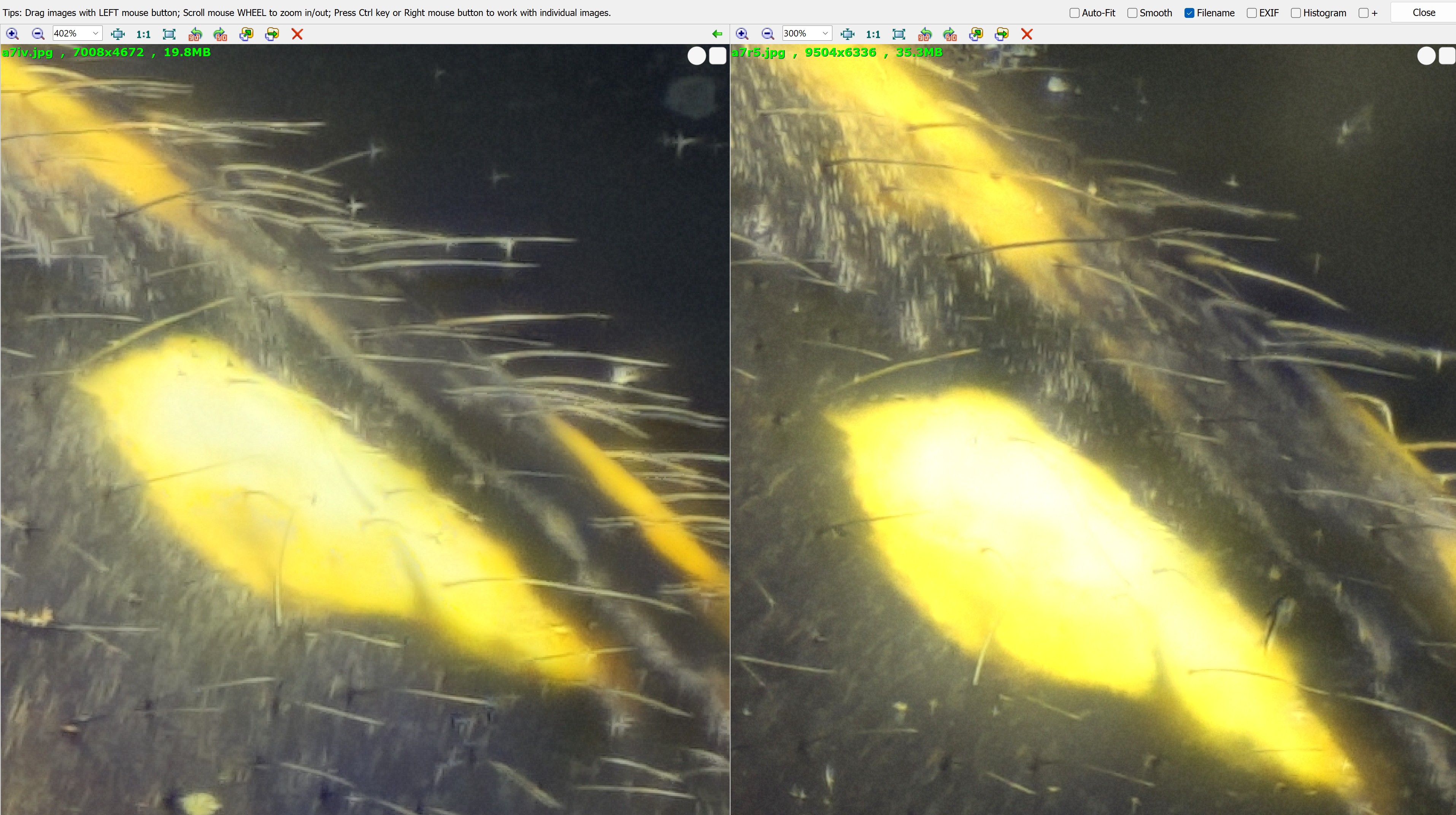

    the whole point is that the larger pixels on the a7iv clearly beat the a7rv from my testing in my studio from the other week, i shot spiders with and the a7iv could capture the tones but the a7r5 clipped the silver consistantly all the time.
    JPG, 1.1ย MB, uploaded by DonaldB on July 4, 2025.

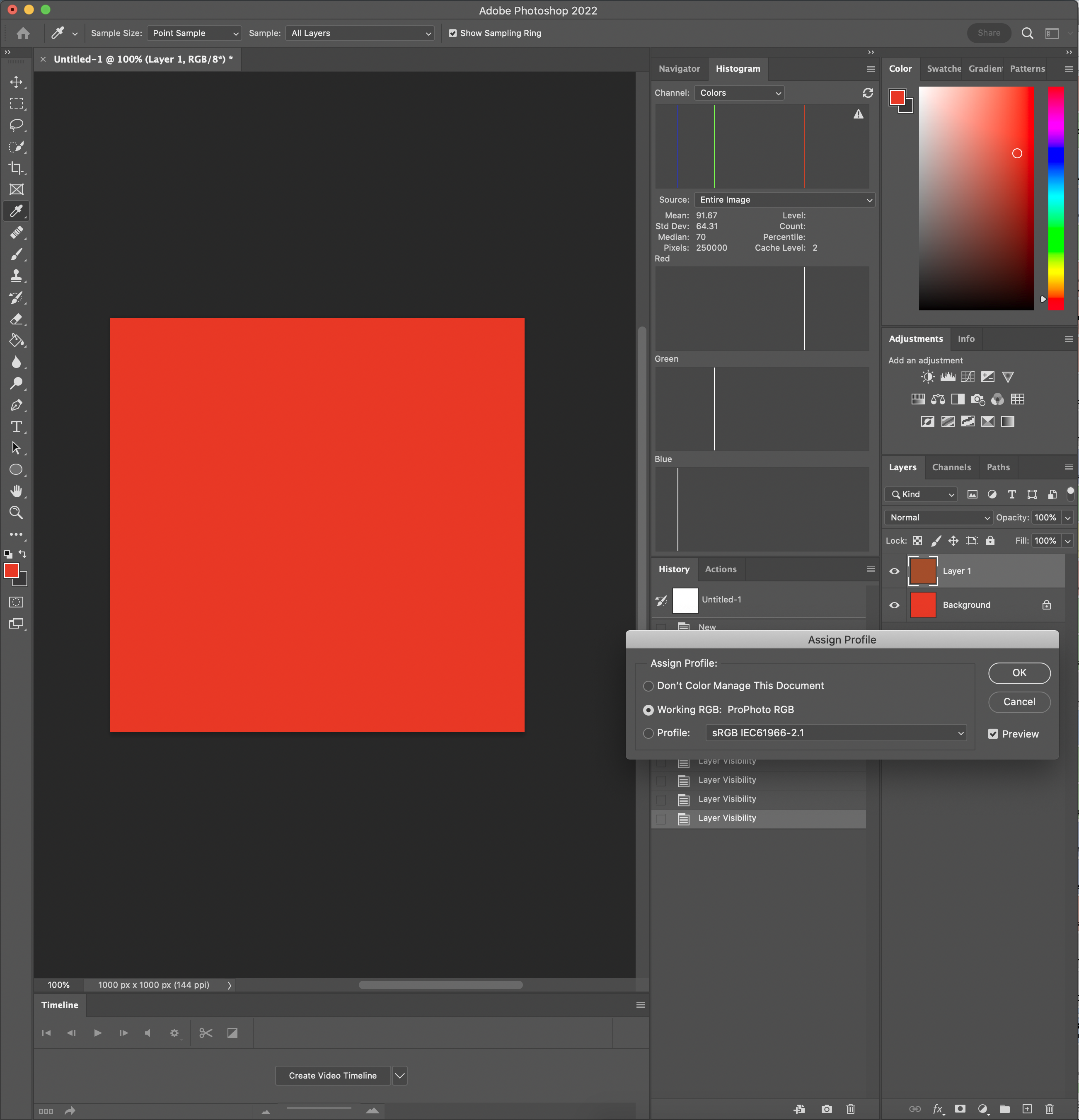

    Entertaining as this all is, I can't help thinking that we've drifted a little here from a consistent topic...
    I'm struggling with the concept of "near clipped". So red + white (pink), is not a valid skin tone because it sits close to the top of the chart?
    Only happens on my computer if you try to read the second sRGB colour with the ProPhoto RGB profile, then it looks the same as the first.
    ๐Ÿ˜€
    PNG, 1.9ย MB, uploaded by Andrew546 on July 5, 2025.
  • Members 2663 posts
    July 5, 2025, 4:18 a.m.
    i havent gone off course at all as im talking about DR, can you give us a figure of how much DR is in the head shot based on the images i have posted ? or does DR increase or decrease with NR ๐Ÿค”

    July 5, 2025, 9:23 a.m.
    Not from screenshots of parts of photos at 400%+ I can't. Nor can I do it from looking at tiny un-scaled histograms which only show colour distrobution post-conversion to your chosen colour profile. You're so far away from absolute data here with so many of the steps involving perceptual intents that I don't see how I can make any assessments of the absolute performance of the camera from the information posted.
    For instance, RGB colour isn't real, it's how to create the "illusion" of colour to the average human eye. (Roughly) because we have three cones in our eyes all the real world colour is converted to three signals that our brain translates to "colour". Additive colour is simply using three carefully chosen bands of light to stimulate the cones in our eyes to produce the same signals as real colour does. The whole system is based on a perceptual intent, plus using three "absolute" bands of real world light puts real world limitations on the range of nerve impulses you can generate in the eye and the colour gamut that represents. So I have no idea where to even start to relate the RGB histogram of your chosen colour profile to the actual sensor data, or how I can see that by looking at the RGB output of a computer screen...
