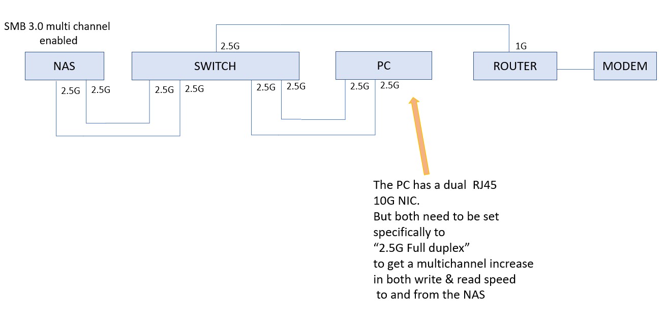

I did some more experimenting and found a solution that fits well for me.
I now have 6 x 8T HDD's connected in a RAID10 config in the QNAP NAS
RAID10 has a faster write speed and is more reliable with more redundancy compared to RAID5, of course this comes at a cost, you "lose" 50% of the total storage space with RAID10.
With the network connected like this, I have a "5G" max speed between the PC and NAS.
Important to note that a single cable connected with 10G between the PC's NIC and 10G in the SFP port of the switch is not as fast as using 2 cables both connected with 2.5G !!!!
The max speed of both read and write is now the same at about 4400Mbps with read speed being limited by the "5G" network speed.
This is fine for me for file transfers.
A backup from the PC to NAS runs at only 1700mbps because it's limited by the speed that my Acronis backup software can work, a bit disappointing but it now runs automatically and there's still enough network capacity in parallel while it's working when needed.
Also installed a new faster WiFi6 access point and 3 more 2.5G switches in the rest of the home network. A new 2.5G router with a faster WiFi7 is also waiting in its unopened box to be installed sometime soon. Then my network upgrade is finished :-)

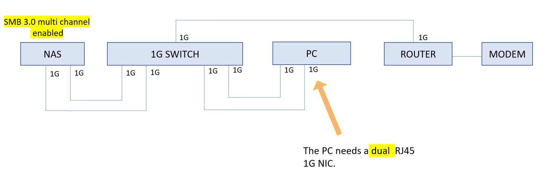

I just read your original question again and I can now see a cheap and easy way to double your current transfer rate between PC & NAS if you want to ,...
No new cables needed, no new switches, just a new dual NIC for the PC (costs about 30 Euro) and one extra cable.
The connection would be like this :
and you'd then just need to enable SMB 3.0 multichannel on the NAS, I assume that is possible with a Synology?, (with my QNAP NAS it is just one "tick" by that option), The switches do not need to be managed, no link aggregation or trunking needs to be set up.
Another nice feature about the SMB3.0 is that if (admittedly in some unlikely rare case) one of the cables should get broken, then the LAN connection still runs without any interruption through the other cable :-)
